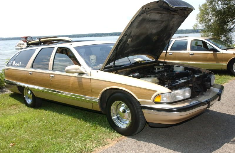

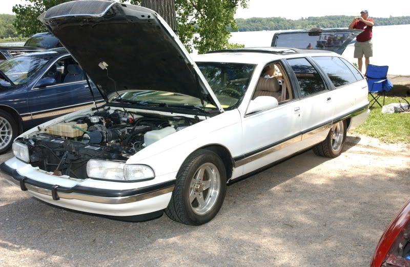

    All the GM wagons have "issues" with belt line trim. On Chevy's the chrome dis-colors and "de-laminates", that needs to be replaced to fix properly. Some remove it all together. The Buicks have a thick black rubber/plastic trim that is taped to the chrome belt line trim and it falls off as the years go by. Fixing the Buick's trim is done a few different ways, one way is just re-glue or re-tape the trim, another is to remove it completely and clean all the residue off the polished pieces it attaches to. You could also strip all the factory stuff off and redo it all with 1 3/8" after market trim, or vinyl tape.
    How it looks with the black trim removed On Ian's Tiki wagon.
    The white Roady below Ian's is how it looks from the factory.
