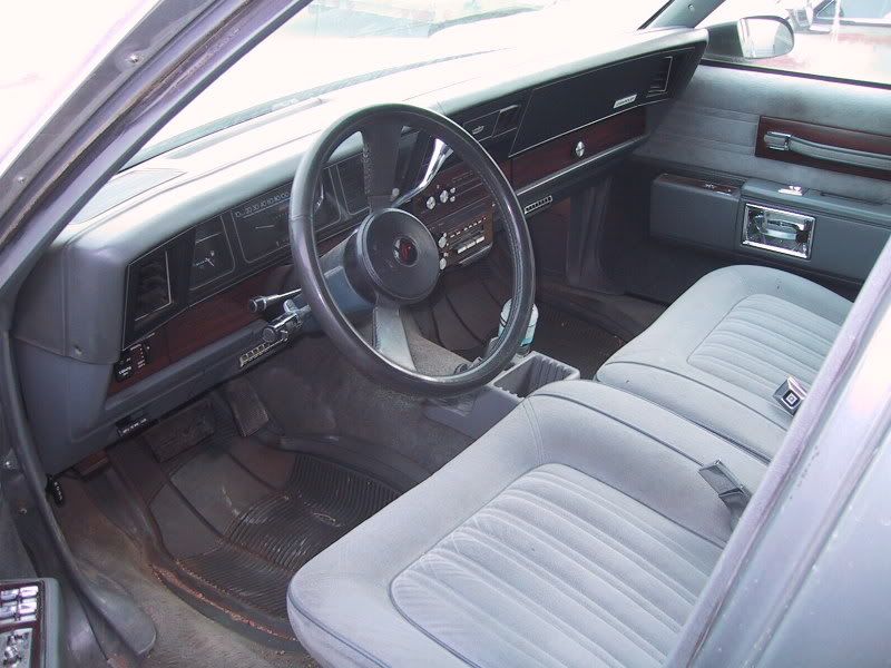

i was at the yard today and saw a nice instrument cluster out of an 87 or newer caprice, its the one with the gauges and trip odometer, so i can replace the base cluster in my 85, that has the dummy lights and no trip odo. will these just swap out, or do i have a project on my hands? i want to use this one http://paloneva.freeshell.org/caprice/caprice22.jpg instead of this one http://i142.photobucket.com/albums/r88/mgtair/caprice003.jpg

lowlow, i know it will fit the dash. im wondering about the things norm mentioned, the sending units, the wire harness, any computers that are under the dash. so i can go back and pull all that stuff while the car is at the yard before they crush it.
Although those should swap out with relative ease (all the connections should be in the dash).....it appears that the one in the yard that you want to put in your car is a kilometer speedo. That may cause problems I am unaware of.
good eye Silver, those arent pictures of whats here at the house. I pulled those off the net just for example. The one with the red interior is in the netherlands or somewhere for sale. The one i pulled is for mph.

i figure the speedo will work, the parts i was curious about were the gauges. my original doesnt have any gauges, but the new one has the amp and temp gauges, and the rest dummy lights.
