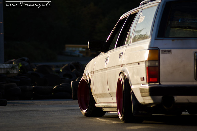

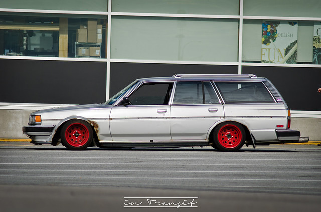

    And you gotta get some wheels on there right? Baller on a budget, 15x10 diamond racing steelies. Going to get something more legit in the future and go skinnier in the front so I won't have to worry when I go for more steering angle in the future.
    The thought with the red was to get a bit of a hot rod/rat rod look out of it. was going to try and find some mooneyes for them too and fake white walls with spray paint but I don't really like the red anymore so that will change soon.

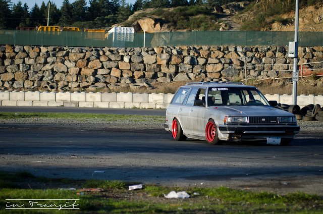

    Springs got cut all around a little more and the rear shocks were replaced with nissan hardbody front shocks for shorter stroke and more stiffness. But everything suspension is just placeholder for now, Going to go coilovers over winter. and this is how she sits right now:
    [​IMG][​IMG]

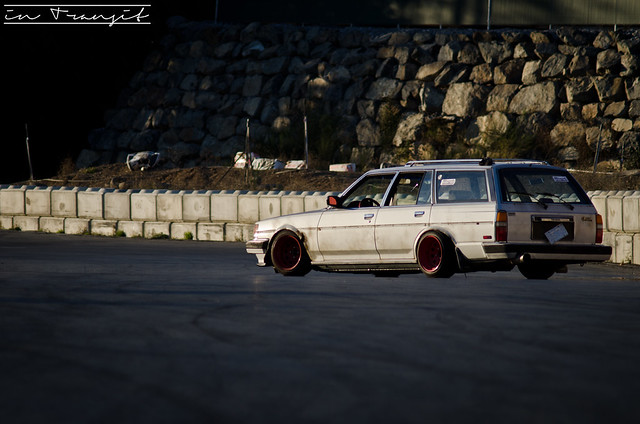

    I took it out to one drift event this past weekend to see how it would do with the **** suspension set-up its currently running. it was uncontrollable. But it was fun and I could feel the potential was there, so I'm stoked to get some stuff done and bring it to the next event.
    Plans for the near future, coilovers all around. swap in 240sx front subframe, steering, custom knuckles, etc and get some more steering angle and power steering. Get a bucket seat and do some cutting to lighten the car up some more, and just doing little things to make the car more unique than it already is.

    I have never heard of your wagon before but I don't get out much. :rofl: Anyway I can see why you like it, nice lines. Glad you found your way here and shared your story and pics. Hope you enjoy the forum...oh yeah, your plate is falling off the back. :D
