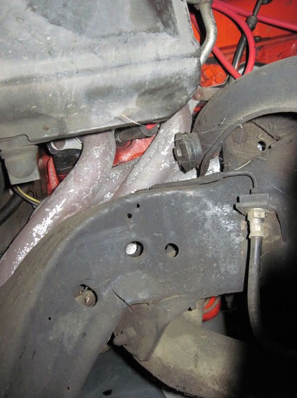

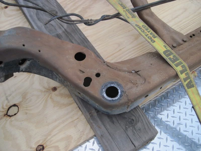

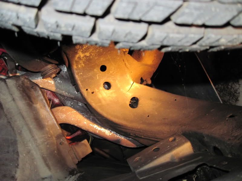

    The frame on my car was hit perpendicularly to the frame-end on the passenger side, pushing the rail back towards the firewall. The portion of the frame under the firewall that kicks out at an angle to meet the frame side rail is now parallel to the firewall on this side, and has a concave section with a crack.
    The concavity from the backwards compression of the rail is visble here.
    There is also a crack on the outside edge of the spring seat, above the lower control arm.
    Most of the shops I have spoken to have said it can be fixed and will be costly. That's when I came to the frame swap plan, as I can get a frame from a wreck with everything I need for under $500, figure about $300 for suspension and body bushings, do much of the labor myself, and have undamaged/unrepaired frame and get my suspension upgraded as well.

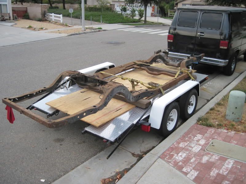

    UPDATE: Got a frame!
    Bought and picked up a frame this weekend, really clean, no rust, supposedly from an Arizona car... Who knows?
    My Monte and Elco providing a background
    tow-vehicle of doom...
    Nice! No rust!
