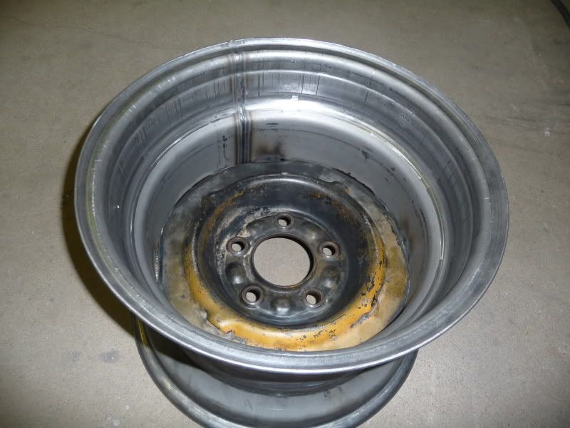

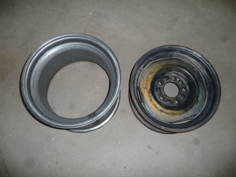

    Here is the new wheel shell, and the wheel I would get the center from. The I.D. of the new shell was 12 5/8", and the O.D. of the center was 13 1/4". Some machine work would be required:

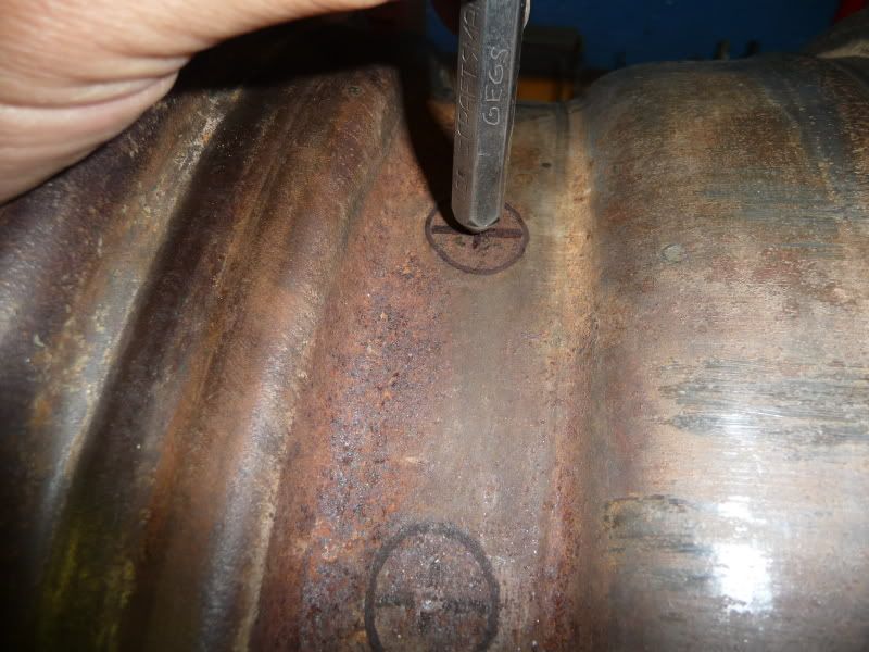

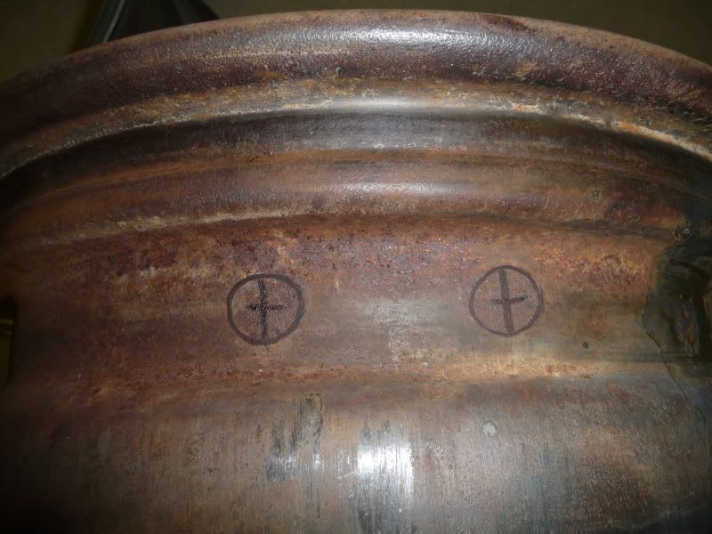

    The wheel center was spot welded in with eight spot welds. The welds are located and center punched. The welds are then drilled with small drill bit at first, progressively getting bigger until a 3/4" drill bit is used:

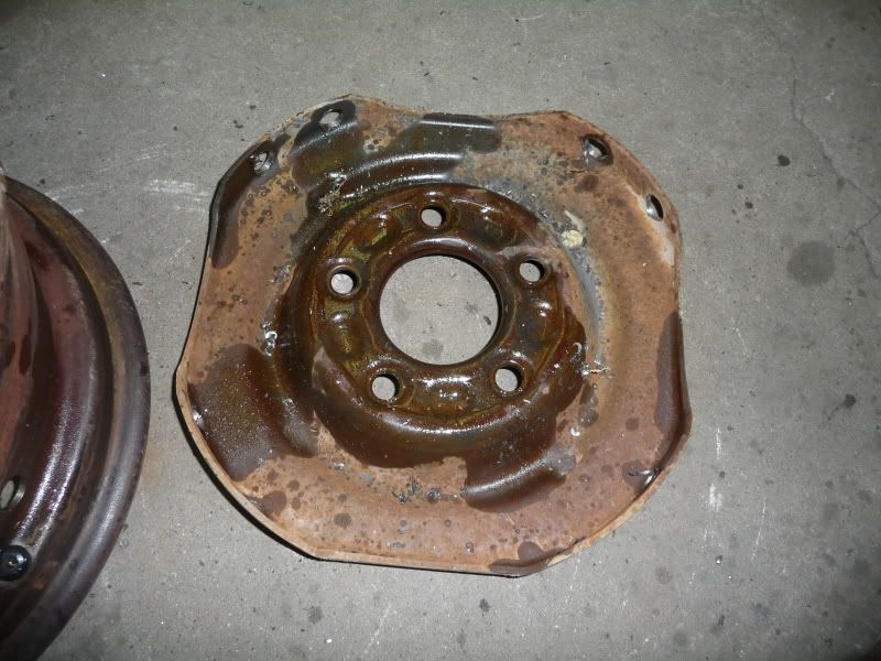

    The center is then persuaded out with a large hammer:

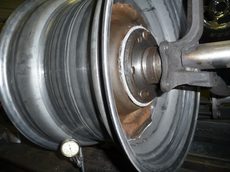

    I use an old spindle with a hub on it bolted to a workbench to true the wheel before welding. A dial indicator is used to get as little run out as possible. This wheel had .020", which is really good:

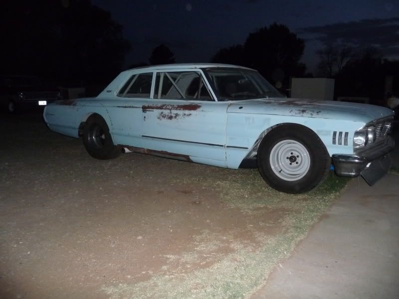

    Here is the car they are going on:

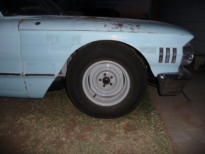

    Here is one of the 15" x 8" front wheels built using the same method:
