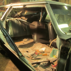

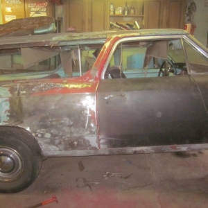

  • Ongoing project to re-design my 66 Malibu 4door Wagon into a 2door Nomad style Wagon.

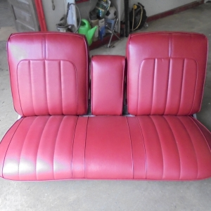

    Process involved longer doors, B-Pillar and quarter sections from an ElCamino. Side window design with sliding quarter glass and 2 piece rear hatch design. The interior will remain stock looking with red upholstry. The front bench seat is from a Buick Skylark with folding center armrest that was never offered in the Chevy models.
    The design plan is for the car to still retain most of the 66 Malibu Factory built look with just enough changes to keep people guessing.
